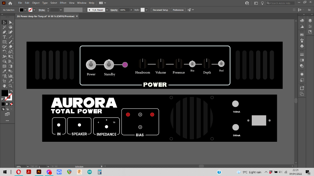

This is something i've been working on for a while. It's the ax84 push pull power amp at its core but i added switchable depth/presence caps and also the scale control from Merlin Blencowes preamp books.
I currently have it all cobbled together in a project chassis but will be reassembling it in a rack chassis this weekend so more to follow this weekend.

For the most part it's very similar to this with a few changes around the NFB and also has a parallel input stage.
https://ax84.com/archive/ax84.com/stati ... ematic.pdf
The heater wiring will be done manually on the sockets which are off board.
The heaters are elevated to around 70vdc and will be run as parallel pairs of bus wire from socket to socket with the winding from the transformer being twisted up to the first valve.
