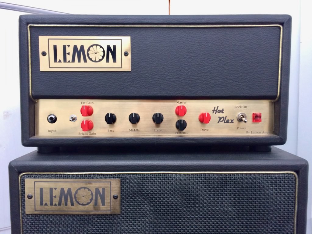

Hot Plex
Hot Plex
Gilles
Gilles

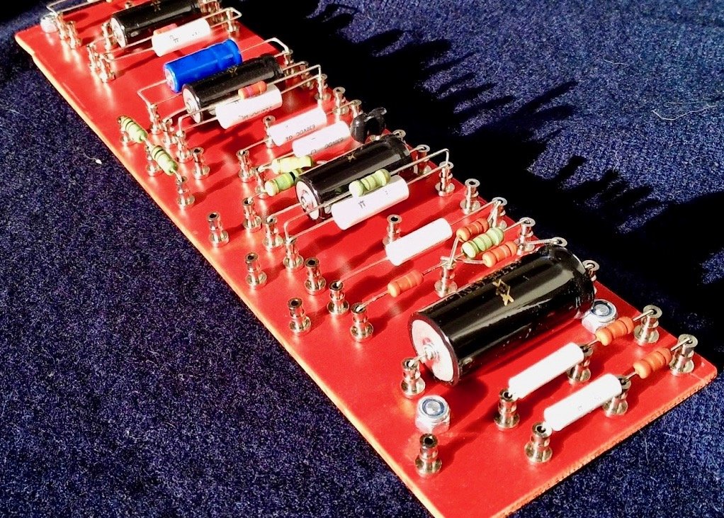

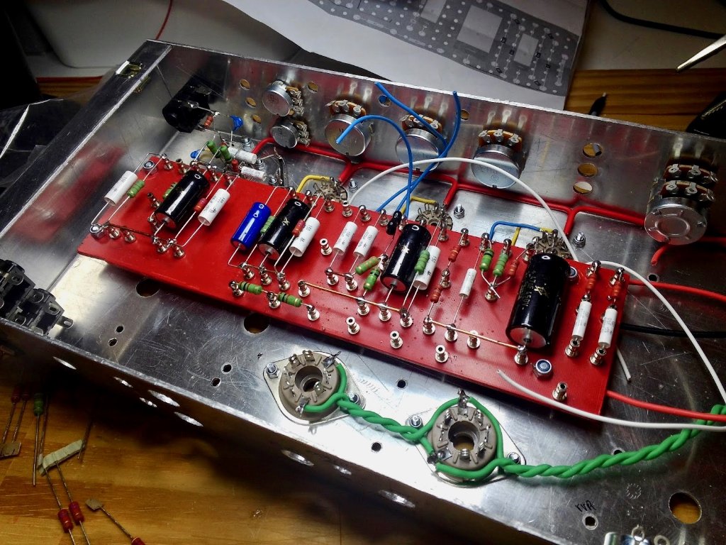

Layout
Layout
Board
Board
