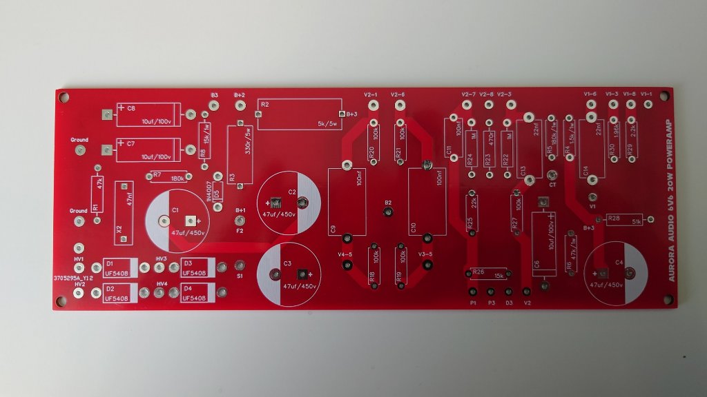

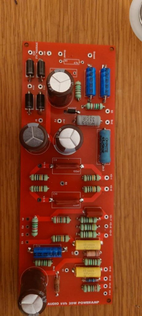

This is something i've been working on for a while. It's the ax84 push pull power amp at its core but i added switchable depth/presence caps and also the scale control from Merlin Blencowes preamp books.
I currently have it all cobbled together in a project chassis but will be reassembling it in a rack chassis this weekend so more to follow this weekend.

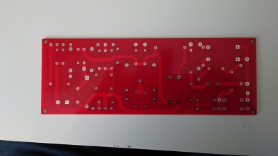

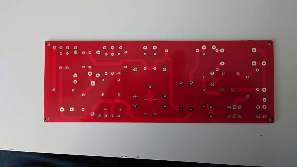

Super nice,
it's a double-sided PCB then?
Can we see the other side?
Re: 6v6 Power amp Project
Yes it's a double sided board. I can't do it right now as my son is asleep in the room next to where everything is but tomorrow ill grab some photos of the underside.Dr. Nonosse a écrit : ↑14 avr. 2022, 18:39 Super nice,
Also note I made it so the rectifier could easily be setup as a bridge rectifier for a friend for a transformer he has to hand along with a capacitor coupled bias supply option for him.

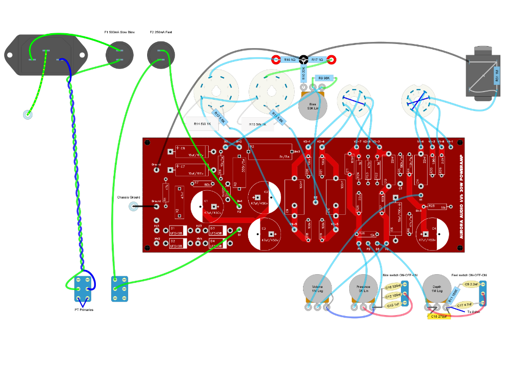

For the most part it's very similar to this with a few changes around the NFB and also has a parallel input stage.Dr. Nonosse a écrit : ↑15 avr. 2022, 22:16 Take it easy,
I'm just curious because I never see the sckematics, the heater wiring.....
Hu ok capacitor filter is quite different from the G5 who use self filter, why not.
Please don't wake your son for that (I know that: I'm brand new dad...)
see you.
https://ax84.com/archive/ax84.com/stati ... ematic.pdf
The heater wiring will be done manually on the sockets which are off board.
The heaters are elevated to around 70vdc and will be run as parallel pairs of bus wire from socket to socket with the winding from the transformer being twisted up to the first valve.
